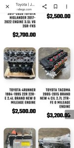

My local machine shop used to do lots of these. they had long blocks in stock. we did a swap in my neighbors truck in an afternoon & it worked out great. might call around for long blocks....
