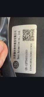

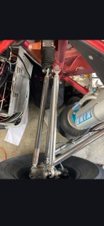

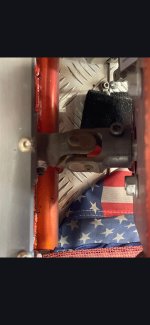

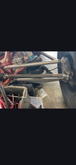

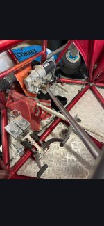

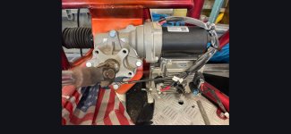

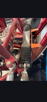

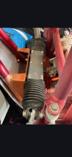

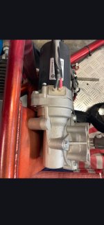

Some photos I got today. He put electric power steering on a Funco Hustler. He gave me permission to post these.
One more showing the tag on that unit.

What system does it run as far as a rack and the unit model itself?
